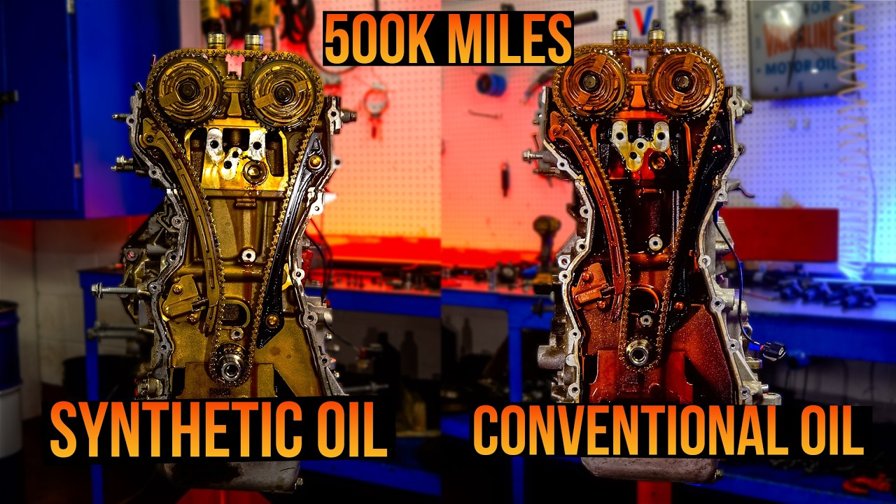

Another member posted this today, mind you a 10k interval synthetic versus conventional 500k miles.
