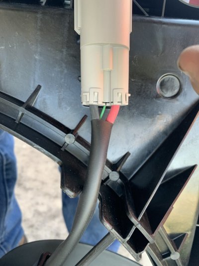

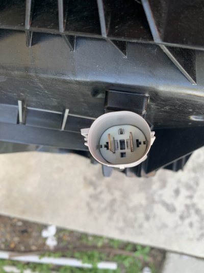

It is not a simple thing. They are brushless motors that require the board in the motor to work but that board requires the pwm signal. I’ve had the pentastar fan running with the module I have. It has a bypass in it to run a 12v switch to the module to tell the fan to run full speed but that defeats the point of having a variable speed setup. Also pointless to spend the money on the module for just that. I’m giving it another go on getting the canbus signal to work then see about the bigger tow package fan possibly being a viable option. From the 5th gen. That’s a huge fan.

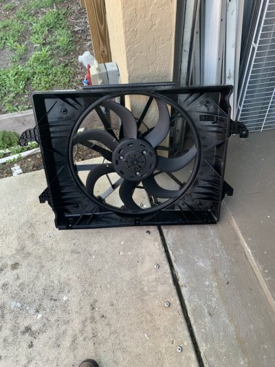

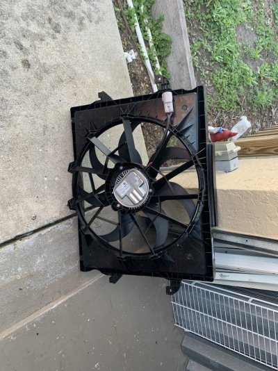

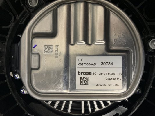

Look what’s here. I need to do a test fit. That won’t be tonight though. This fan looks like a monster and looks well put together. It looks like it should line up too but won’t know till I get a free afternoon next week. The motor directly says 600 watts. Anyone with a v6 2013 and newer can see if their fan motor is labeled?

Ram7081
Sep 9, 2015
473
173
2025
Hurricane 3.0
That's awesome.
I'll see if my OE V6 has a label and if so I will snap a pic in like an hour or so.
crazykid1994
Sep 21, 2013
5,063
5,064
Florida
600 watts

Ram7081
Sep 9, 2015
473
173
2025
Hurricane 3.0
OE V6 efan. Bought at local dealer. Doesn't show much.
I used a tool from Amazon and CFM was 3250
