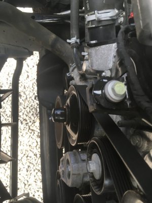

Awesome! The threads on mine are starting to rust I'll definitely take a look at that...
Check through your old spray bombs,you might find a cap that fits .I use a similar cap off an old WD-40 can I had laying around,a touch of black Krylon plastic paint,and it screwed right onto the threads.Been on the truck for 4 years now,and still looks good. I shift my truck at 6600 rpm,and the cap has never moved.
Oh damn I have a bunch of those kicking around thanks!
