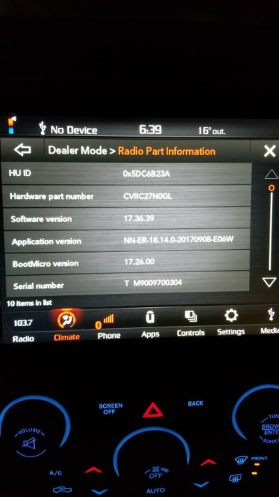

My truck is a Canadian 2015 Ram 1500 Quad Cab Sport imported in to the U.S. It came with the RA3 8.4 (no Nav). 6 speaker sound system. The radio I put in is a 8.4 4C UAQ radio with CarPlay etc from Infotainment.com. The info off the radio is:
HARDWARE PN CNSC27N5FL
SOFTWARE VERSION 18.20.2e
APPLICATION VERSION USA-IR-21.9.0-20180516-109V
BOOT MICRO 18.10.01
SERIAL NUMBER T M9234801884

Here's the radio info:

v18.14 and 19.9 work well. v21.9 & 22.5 are the ones with audio EQ problems.

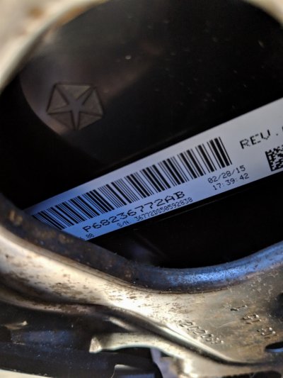

Another data point from Goofy...
2015 ram 1500 with factory dual zone ATC and 13-17 HVAC module...
Just wanted to report that I installed a brand new 2018 UAQ in my 2015 Big Horn with Dual Zone auto Climate about a month ago, I finally got a chance to check on my climate control mixer. My truck does not need the 2018 climate control module, when the temperature is set at 70 and the ambient temperature is about 40 degrees, the mixer door goes all the way up to give me full heat, and if i force the temperature down to "LO" it goes down to full cold. That being said I'm gonna have a brand new in box 2018 Climate control module up for sale very soon once i get some pics.
Yea using my plastic pry tool helped a bunch, here's the part number:
Also it's Revision A
