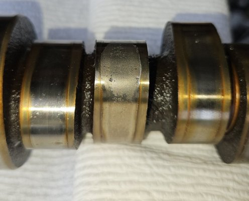

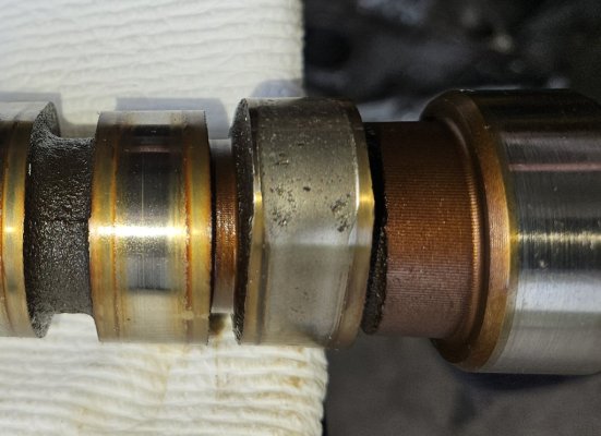

So, sounds like the lobes were going first on those?
Seems to indicate that the cam metallurgy is more likely the problem than the lifters, if the lobes are going first.
My thoughts, too.
I think maybe the heat treat on the cast iron cam isn't very thick. My #8 lobes showed pitting where the wear was starting, and it was definately wear because you could feel it with your fingernail.

View attachment 572267View attachment 572268
this is the number 8? any pics of the lifters? with wear like that there definitely should be some sort of wear on the roller of the lifter

Yes, both lobes. I will have to get you pics of those rollers, here's a vid:
at second 14 in your video, its hard to see exactly on my phone but it looks like that roller has no more chrome finish, possibly some galling.
which is to be expected considering the damage seen on the cam.
I will have to look them over closer. I will take some pics for you, might be a couple days before I get that far.
