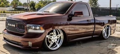

this my brother....this is the best looking grill I’ve seen on a 4th gen (bbiously my opinion)
but you always hear people say you can’t paint chrome etc.
However this grill was made I dunno...but I’d love one. Slammed isn’t my thing but the front end is perfection right here
Completely agree, if I planned on keeping my truck longer I would absolutely look into wrapping the grill and a few other things. I've heard the concerns about painting chrome, or how it would hold up. Not sure what would last longer, the paint or wrapping it?

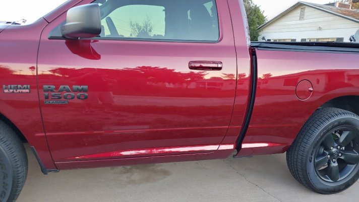

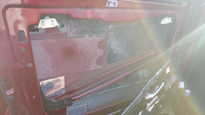

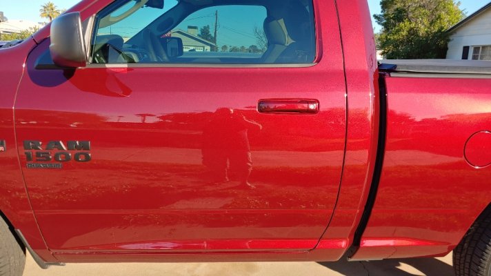

I finished the swap today. Man that's a lot of work, but to me, completely worth the effort. I also took the opportunity to add some sound deadening since I had the inner door skin off anyway.
Before:
After:

The first door will probably take 1.5 hours or more as you figure out what to do. After that, each one will take a little less than an hour.

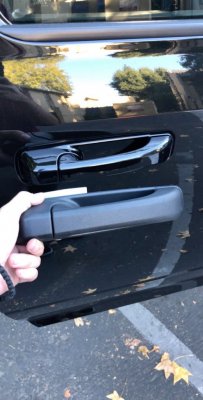

I replaced them too on my 17 reg cab but I was able to do it without taking the inner door skin off. Took me about 45 mins in total to swap them out. Painted definitely looks wayyy betterIMG_0246.JPG

You'd have to take the door panels off, but you could undo some of the bolts on the upper corner of the inner door skin and reach in there to get to the 3 bolts that hold the handle on. Every time I try a short cut, it ends up being a bigger pain in the ass so I just took the whole inner door skin off. It's not that hard to do really.

how did you do them without taking the door panel off
I went through the access hole in the door but you have to have skinny arms and patience to go that route because it can be a little frustrating. I believe the access hole is a little higher on the regular cabs then on the other cab sizes which makes it easier on the reg cabs. I didn't need to loosen any of the bolts on the panel either.
I looked where the bolts were on the new handle and went at them with a little 1/4 drive ratchet. Once the bolts were loose I put some painters tape around the handle on the outside to protect it. From there I pulled the handle and detached the rod connecting it. Before connecting the new handle I partially screwed in the bolts into each of the handles bolt holes and removed them. They aren't threaded from factory and are nearly impossible to get started when going this route. I started the bolts by hand then tightened with the wrench. Other than that it is just reversing the steps till its all back together.
Took me probably 45 mins MAYBE an hour tops to do both sides in total.

I took the whole inner door skin off, and I didn't remove the glass. I did have to unclip it from the regulator and tape it in the up position, but that wasn't too hard to do.

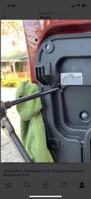

panel hole.jpg Just drill a hole in the inner door skin big enough to fit a socket in with an extension,thats what I did,very easy,10min a door.

I don't see how drilling one hole is enough, as there are 3 bolts holding the handle on. Taking the door skin off, if needed, isn't all that hard, just somewhat time consuming. Doing so, does give full access to the door for sound deadener, if one wants to do that.
I'd also recommend buying them, as they were only $88 plus shipping for the pair and match perfectly.

pentastar
I put sound deadener in mine also, one hole is enough to easily reach the three,I've done it
