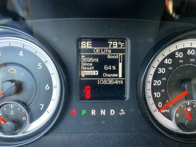

I’ve had my truck a year, it is a 2016 with the 5.7. I change my oil every 5000 miles on the nose and I’m at 4000 since the last change now. I have never seen this light before today. Does the computer knows something I don’t?

Did you reset the change oil indicator when you did the last oil change.You can use the button on the steering column to reset it,but it'***** or miss on it actually resetting the indicator,the full proof way to reset the indicator is turn the key or ignition to the "run" position,but with-out starting the truck,then depress the accelator pedal to the floor 3 times in a row with-in about 20 or 30 seconds,turn key /ignition back off,then start truck.

Turn the key all the way to on without starting the engine and right away, push the pedal 5 times (could be 3 i just do 5 because that's what i've been doing it for years with other vehicles), then start the engine and check the status on the oil. Should be 100% if you did it right. You can also reset the counter from that same option.

Does yours have the 8.4 screen? I go to truck info and cycle till I get to the oil life screen. Then I think it’s press and hold the steering wheel control right arrow.

Yes I do have that one. Will try it. I also ahve the pushbutton starter so maybe that's why that one didn't work.
