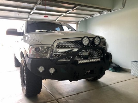

whats the lighting you have? asking cause i like lights and have mine lit up as well.
Thanks for the inquiry, I like lights very much.
I have two VisionX 6’7” ADV light cannons, four VisionX 4’7” multi led CG2 light cannons, 20” Baja Design ONYX+, pair of Baja Designs S1 amber wide corner.
Any questions about any particular light? I don’t mind derailing this thread lol. I already got the battery from autozone. The one above that I pictured.

Any knowledgeable battery people out there? I need a new battery for my truck....
I have a lot invested in high end lighting (just over $2,500) and, since the lights draw power right off the battery, I want something quality. Thank for the input.

hey thats really cool! i wasnt expwcting lights like that. i went with the more decorative lighting haha. leds everywhere. do you do alot of off roading? truck looks great!

Thank you! I started getting into lighting after I destroyed a deer at highway speed. I kinda felt bad for the guy and it really messed the front of my truck up. Hence the steel bumper. I bought a high end light bar to use on backroads and it was all down here from there hahaha.
Just the light bar only:
