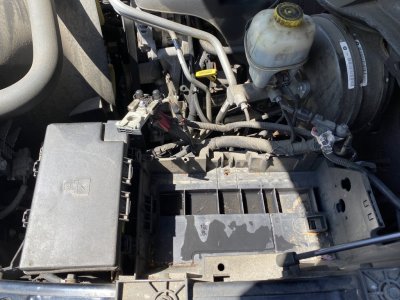

If you need a little extra the H8 fits in the Ram once you remove the plastic spacer in the housing. Not sure if this helps. I stuck with the H7 AGM from Advance with a 25% off coupon.
Just looked this up and it seems to be a common mod for Jeeps. What spacer do you remove?

Look at the battery end nearest the firewall. You’ll see a gap 1.5-2” and follow it to the base. There will be a small plastic clip that sets against the end of the battery. Just pop that out and you can now use the extra space.

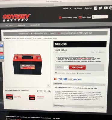

Any knowledgeable battery people out there? I need a new battery for my truck....
I have a lot invested in high end lighting (just over $2,500) and, since the lights draw power right off the battery, I want something quality. Thank for the input.
I bought that battery for mine, works great.
There are plenty of 20% coupons out there, plus I had a rebate card from them and the battery had a rebate.
Ended up costing me ~$120 in the end.

Just bought the diehard at autozone H8. 17 model with 41000. No worry about losing any settings, at least I didn’t. Broke the tab on the spacer. 199.00 with core exchange. That SOB is heavy, get your wife to put it in.

I have a question.... that "blanket cover thing" that's on the stock H7 size battery, does it fit the new/larger H8 battery? If not, is it needed?
I bought a new 2013 RAM Longhorn in December 2013 and had battery issues with the OEM just 2 weeks later ... the dealer replaced it with a new one and still had issues with low battery problems ... I went out and bought a $400 (Canadian) NORTHSTAR AGM battery (made in USA) from a local battery shop and I never had any problem with it ... I traded my 2013 Ram in for a new 2017 and had the dealer put my Northstar battery in my new truck ... I traded the '17 in on a new 2020 in February but unfortunately I forgot to have the battery changed ... In any event it was still going strong, never had any problems with it even in our cold winters here in Canada ... I would highly recommend ... If I ever need a new battery, I would purchase another Northstar without question ... Well worth the money ...
