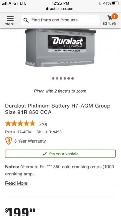

you got good cold crank amps with your choice at 850. The hemi requires that even in warm state. Sadly last I checked Optima didnt make one for the 1500 rams. You may opt for a HD alternator and do the triple thingy, increase wire gauge in 3 areas. I have to call the expert on this, he just did his last week... calling @Hemi395 aka Corey.
The factory battery for the Hemi is 730 CCA(regular flooded lead acid battery), even the EcoDiesel rolls off the assembly line with only a 800 CCA (AGM) battery, not sure where you came up with the Hemi requiring an 850 CCA.
