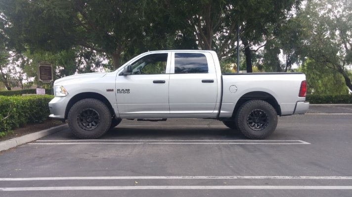

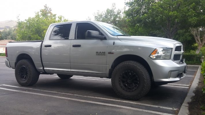

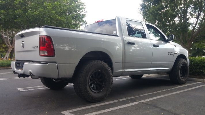

Icons won't give you 1.5" exactly. they'll settle down to about 1-1 1/4"
This was Rancho QL's front (2") with the Icon 1.5" springs in the back
Not a lot of rear rake if you're worried about that, but better weight management when loaded compared to stock for sure.
