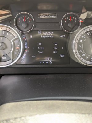

I guess mine are high compared to my mileage. I dont let it idle much, maybe guy before me did as he only put 5800 miles on it in 2.5 year of owning it.
I do have that few second start up tic occasionally, more so if started/ stopped and started an hour or so later.
