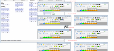

Shift points could be adapted to whatever you want. 6 speed for example below, Driver select mode should the manual shifts, don't know why the factory did this but it'll auto shift up/down depending on that output shaft speed and throttle position. If you wanted to hold 2-3 just increase your output shaft rpm at say 27.5 TP%, maybe less (could it be a matter of observing what the TP% during coastdown, then using that value as reference, the axis can be changed to match whatver you want :))
The numbers you see in the tables are output shaft speed. Easy to know what engine rpm would that relate to if you do the math, Output shaft RPM X trans gear ratio

Shift points could be adapted to whatever you want. 6 speed for example below, Driver select mode should the manual shifts, don't know why the factory did this but it'll auto shift up/down depending on that output shaft speed and throttle position. If you wanted to hold 2-3 just increase your output shaft rpm at say 27.5 TP%, maybe less (could it be a matter of observing what the TP% during coastdown, then using that value as reference, the axis can be cnaged to match whatver you want :))
The numbners you see in the tables are output shaft speed. Easy to know what engine rpm would that relate to if you do the math, Output shaft RPM X trans gear ratio
