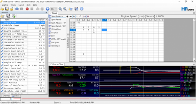

Lets practice VCM logs wild one. I'll give you the run down as a 3rd grader.
First cold start this morning, 57F ECT, notice the timer down below in case you didn't know it was there.
about 2.7 sec engine has rpm, note the rpm up top, in case you didn't know it was there. in this case 1630rpm though i don't think you'll have problems reading that, apparently your reading skills are fairly special....
About half way on the left pane, i'm logging Fuel system status, what's the status again? say it with me.... OL - not ready, again i doubt you'll have any issues getting that but you never know

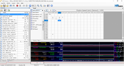

14 sec in the scanning still, OL -not ready, Oh my god ... 1291 rpm idle
And then 15 sec in the scanning, what's our fuel system status,, say it with me CL - Normal, ST's and LT's posting...... 1291 RPM, and what's the ECT again ??? hahahahahahahaha...... 59F. This doesn't change because the truck is 2018. this doesn't change because the OP has an 8 speed and it's stock.
Substract the 2.7 sec maybe a little more since i started the scanner before starting the engine and the clock is close to what ? 10 sec, opppssss.
If you would take the time to observe you could achieve a very basic level of understanding. If you don't take the time to listen, Tuning is not for you....
What was it again Wild one???, the leanness, the richness, the pulsing, the TB moving because the OL moving pulsing the TB blade and the dude is 67yo and i'm assuming yada yada yada yada, becasue the 160T gives an error to a stock 8 speed trans bla bla bla bla, because unless your coolant is at 160f you're still in OL bla bla bla bla bla...
Now you have an idea of engine rpm, TP% and you can take a look at what the trans tables call for tp% i bet that TP goes down once you reach min idle. We'll have to look at his TP% going down hill along with trans temp, coolant temp, spark, etc etc to know what the truck is doing and ideally come up with a strategy approach to fix it via tuning assuming we can control what it's causing the issue. it's not going to get fixed by FCA because the OP raises his hand and tell them hey look at me, my truck is running wildly down the hill in 2nd cold, but 3rd gear can control it hot. lol but is it really an issue ? or more of a "desire", two complete different things.... FCA won't fix either one unless there was something mechanically wrong with the vehicle and it was still under warranty.
