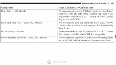

Gaskets are reusable, I’ve done both front and back. No friction modifier needed.
the big debate is always,
75w-90 vs 75w85
I’m a 75w90 truck since my 2016 owners manual states it in the chassis portion of the “gas” section. The chassis portion of the diesel section states 75w85. Not sure why their is that discrepancy, both trucks must use the same chassis components.

Here the 75w90 from the 2016 manual for 2500/3500
75w140 for 1500. What year did the make the switch? 2017?
