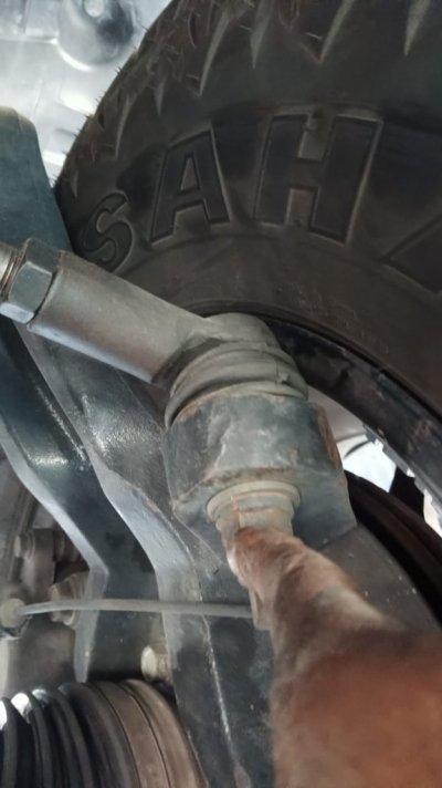

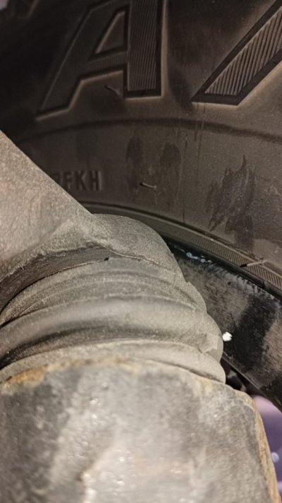

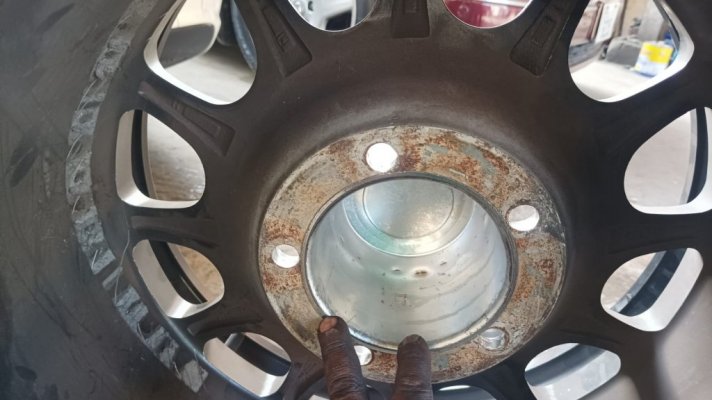

I got the Method rims repaired and the wheels balanced again at a different shop. All looks good. However still the vibration persists. I took it to my mechanic and he noticed that the tie-rod ends we touching the rims.
He took it to a shop and they suggested that I put spacers because the Method rims aren't properly seating well on the hubs. The reason being that all that is holding the rims in place are the bolts and nuts. So far I've not noticed it being an issue.
WhatsApp Image 2023-02-08 at 16.24.48.jpegWhatsApp Image 2023-02-08 at 16.24.32.jpegWhatsApp Image 2023-02-08 at 17.03.08(1).jpegWhatsApp Image 2023-02-08 at 17.03.06.jpegWhatsApp Image 2023-02-08 at 17.03.08.jpeg

I would sell those rims and get a properly fitted set with the correct offsets. Touching ball joints and adding spacers is WAY not on in my books.

I think the new tires may have something to do with the rubbing problem but I have to say, the first shop is not very impressive since they missed this when they mounted the tires and balanced them. They also missed it the second go round when you were complaining about the vibration as did the second shop you went to. I would be going back to both of them and demanding a refund of the fees for mounting and balancing. Best of luck.

I chose the rims because they had the correct backspacing and offset suggested by BDS on their site. So when the shop mentioned to use spacers, I was a little surprised.
As it turns out, part of the issue a vital step was missed when installing the 4" BDS lift kit. The tie rods need to be trimmed. The mechanic installing the lift did trim the tie-rods, but not nearly enough. To add to the issue, I bought the kit used so the tie rods ends that came with it were a bit worn. The stock ones they replaced were in a worse condition. So I would have to get new ends.
Once this is done, there should be no more issues. However, I will be there is the fact of the rims only being held on by the studs and wheel nuts.
The mechanic suggested spacers to make the rims more hub-centric or replace the rims. I don't see the need since I have been using the same rims for almost 6 months with the same hubs and didn't have an issue till now.
Eventually, I will move away from the methods and possibly into something with a -12 or -18 offset, but I need to save up for them.

The lip of those center caps you installed may be preventing the wheel from seating properly causing a vibration.
