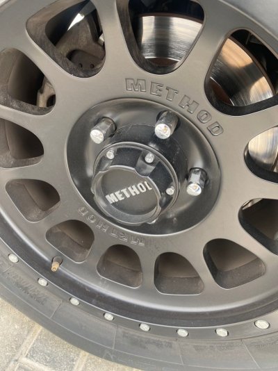

I know that Method rims are popular and have a certain reputation when it comes to off road rims. However I'm not happy with the set that I've got.
I got them from a retail store here in U.A.E. and to be honest, I wasn't really convinced on the style, but salesman convinced me.
Based on the reputation, I thought that I was getting a good set of rims. I bought them in March and haven't been off road with them yet. Just been on the normal streets. However noticed that one of the rims is missing a bolt on the rim and another one is missing a center cap. I have no idea where they could have fallen off.
Checking the rims, I noticed that the center caps come out so easily. Hardly any effort at all. I took a video to show it.
Method Rim Center Cap
I find that given their reputation, these shouldn't have come out so easily.
I emailed Method and told them about my issues. One person got back to me and asked me for pictures and video. I sent him all the information. Never heard back from them again.
Today I noticed that another had fallen off.
I've done a search online and this is a known issue. Most people just live with it and run without center caps. I'm not content with that? What can I do?

Nothing you can do really, I would never buy Method wheels with those center caps. I don't know why they kept or keep making those center caps , at the wheel company where we made wheels, those centercaps when it from the inside and pushed their way out "push through center caps" so that they remained secured ... they also served as hub centric rings for some trucks because of the larger center bore ...
Sucks man, but honestly I doubt you will get a response from them or have them send you new ones ....
You can buy a different type of center cap and replace them something like this
Or the push through ones here but these are from Pro Comp .... you have to find out what size bore you have to get ones that fit nice and tight .....
Nov 20, 2018
74
Riverside California
2018 2wd
HEMI 5.7 Revolution 4.88s
The center bore for those wheels is 108 mm you can get the actual replacements from 4wp here
but I don't know about them shipping to you out there ... if you do get replacements I would find a way to secure them better, maybe add some epoxy to have them stick on without them flying off ...

There are push through ones like this
The 305 Rims that they are mentioning here look like the ones I've got. But I'm uncertain about whether it will fit.

@Burla thanks.. A guy named Steve from Method got back to me. I'm not sure, but I think he was offering to send me a set of replacement caps.
I recently found out that some fitters use silicone when fitting these rims to make sure that the center caps don't fall off. I guessed the seller that sold me these missed the memo.
Another thing I noticed. My caps are all missing on one side. Maybe I'm a victim of theft, however there is no way to prove it for sure.

FWIW, I've never had a problem with my Method center caps.
I don't think that the problem lies with the center caps on my rims itself. Not all Methods. For one, my caps are 1/2 plastic and 1/2 metal. However these are just snapped together. We realized this soon after. Metal and plastic react to heat in different ways. I'm guessing as I drive, the heat on the tires and wheels increase and metal increases too.. Thus making the plastic bits loose.
I looked at the Method site and these look like the ones on my wheel.
However, these are held together with screws. I saw them again for sale on ebay and the seller said that they came off a MR305 Method wheel.
Mine is a MR305 wheel. Why didn't I get these screwed-in caps?
@Burla I wouldn't have gotten the Methods if it weren't for the fact that I needed to change the rims to fit the 4" lift. I needed wheels with the correct backspacing and offset.
I like them. I wasn't sure at first, but they are growing on me. I saw another set of wheels later at a different shop and those seemed to be more my style. I may later on change to those. But for now, I would like to get a set of caps that will fit my rims for a decent price.
My friend is suggesting that I get metal ones since Methods are only plastic.

I don't have a close up photo right now, but I'm 99% sure my 305s have the center cap with the screws like your link.

Based on my time in the ME, first thing that pops into my mind:
Did you get counterfeit rims?
There's so little customer protection and forged/counterfeit goods were rampant when I was there. If you didn't buy directly from an OEM or verified authorized seller, odds of fake products were high.

Yeah.. that does come to mind. I got the set from a retailer in Sharjah. I don't know about counterfeit rims and if they exist - especially Method ones.
I am starting to suspect though since the box they came in say DW100 and the center bore is 111mm.
So far when I search the Method site, my wheels are supposed to be MR305s and should come with above linked center caps. The bore of the center caps are 108mm as per another seller on ebay.
