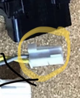

2020 RAM 1500 Classic. I’m having issues removing the smaller connector. I tried pushing down and even that middle tab on side that can be pushed up or down. Worried gonna pull wires or break it. Can someone show a video of the smaller harness connector please. Hopefully mines not stuck. I am worried if I can’t get it out in the future and have to go to dealer for something since I’m still under warranty.

You need a needle or something similar and go opposite of what you would think.

Thanks but could you be a little more elaborate please.

I think he's talking about, we use to have a amp pin removal tool that putting it in the opposite end it would push in the locking ears on that pin to remove it, that connector looks like the his end only doesn't that plug into the can buss?

I did contact them and no word. Instructions only showed how to install. I used a small pick tool and was able to push the tab down and remove very carefully. Thanks for all the help.
