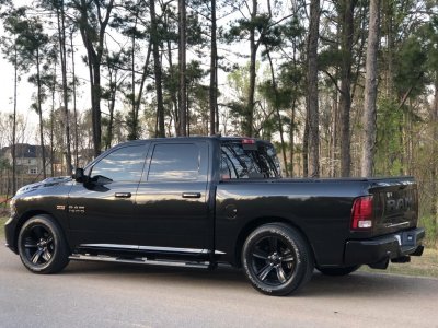

Belltech 2/4 drop -965SP Kit with Inez no cut brackets and your solid... Comes with new end-links, trackbar relocation bracket, bump stops & street performance shocks.Just got mine installed a few weeks ago and love the stance so far. Going to be adding 22" wheels soon and may go to a 3/5 drop...
Beautiful truck with the 2/4 drop! I have the same drop on mine but will be going with a 4/6 soon. I got to close up that wheel well gap.
Beautiful truck! Would you recommend the shocks?
