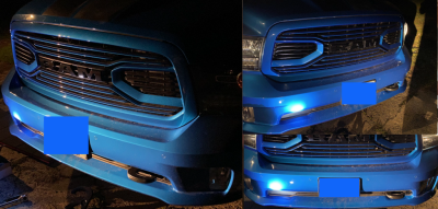

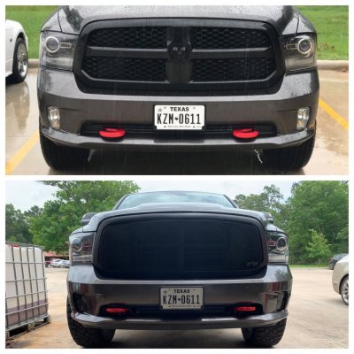

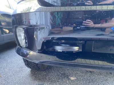

Well guys. I finally did it!!! Took 4 hours because I didn't have a deep 18mm socket so had to run to Lowe's and then working on the last hook the damn Harbor Freight 1/2" torque wrench exploded!! So got stuck using 3/8" torque wrench with breaker bar and shallow 3/4" socket which absolutely sucked.
Shoutout to @crazykid1994 for the tow hook brackets (sanded off most the rust then did 3 rust base coats & 2 black top coats), eBay for the bolts & tow hooks (new without box and slight scratches I'm hoping don't rust), and the one member on the forums for the BEAUTIFUL trim recommendation to clean it all up (woulda looked like trash without the trim)! Only complaints I guess are the trim where the two ends meet, didn't think about it before installing the hooks permanently or would have had to trim piece end another way and it’s not EXACTLY even on each side, but can't complain actually came out wonderful.

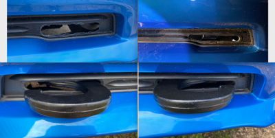

Bad quality (low light) pic, but I got my custom brackets and tow hooks coated in bed liner this week. Ready to be installed. Hopefully get a chance to get to it this weekend.

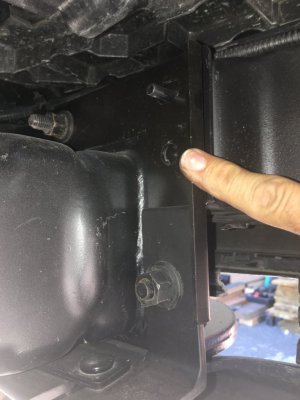

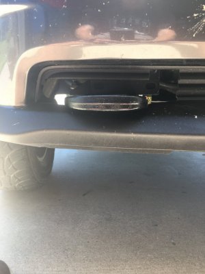

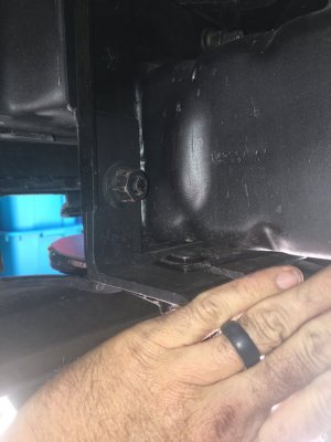

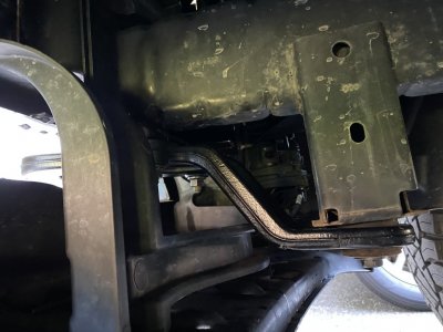

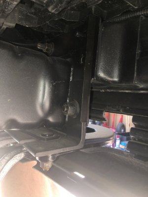

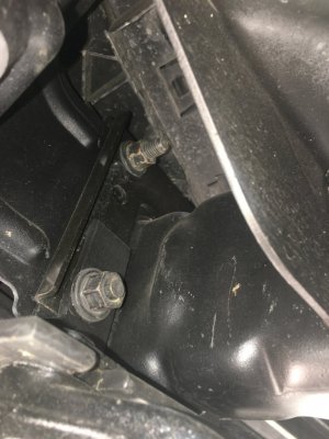

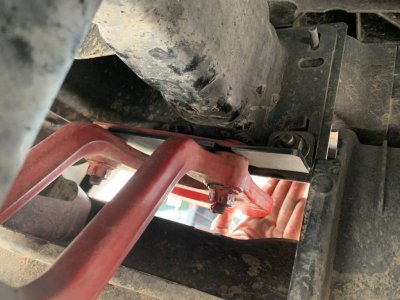

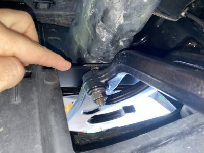

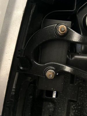

I want to show the brackets I made, based off @JB1 design. I had to re-engineer them to work with my Zone 1.5” body lift. These are made of 2x3” angle iron, about 1/4” thick.
Sorry for the pics, the sun was hitting just right and a few look like I took them with a potato.
With the tow hooks mounted with the body lift, they sit lower in the opening and just barely touch the bumper (it’s an Express). If I could find 1/8” angle iron in this size there would be no contact on the bumper. Also, the tow hook angle is nearly parallel to the road surface, not quite flat but IMHO still going to do the job if needed.
I’m pointing at the C bracket for the body lift.
Yummy rusty bolts and nuts.
As you can see, I’m retaining all the stock hardware, but yeah I could probably get longer carriage bolts for extra peace of mind.

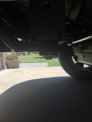

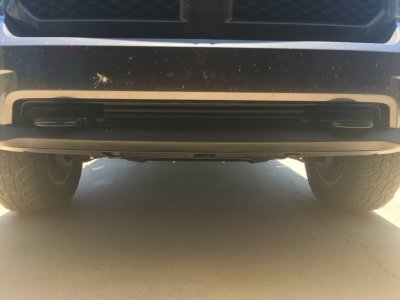

The body lift with tow hooks is not for the faint of heart. It took me a few days to get all the measurements perfect, especially using just a grinder and drill. Again, @JB1 was a huge help in his initial design of the tow hook relocation brackets, I just improved and enhanced the design to work with a 1.5” body lift.
I will put it out though, if you go with a 3” body lift you will lose your tow hooks if you try and mount them in the OEM location, I wouldn’t look forward to figuring out that project.
Side profile showing the angle of the hooks. This looks real exaggerated as I couldn’t get a perfect shot, the rough angle is 5-10*, I don’t believe enough to be an issue while in use.
From underneath angle.
