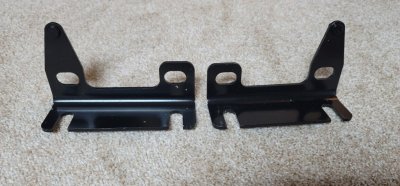

Oh damn didn't even see that, thanks! Did you ever find your brackets? I have the ones from the set I got off Amazon. They are the enixwell ones. I got the custom brackets so no use for them, but they aren't both the same, they messed up and sent out mirrored versions. It could still work you would just need to cut the ear off the passenger side one. I could send em to ya if you wanted no charge
Sure I'll take them because I was going to use the brackets from a 3 gen Dakota that would've worked but everywhere I order them I received oh sorry turns out we're out of stock.

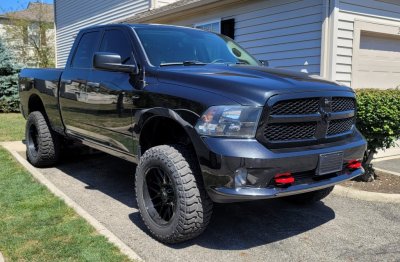

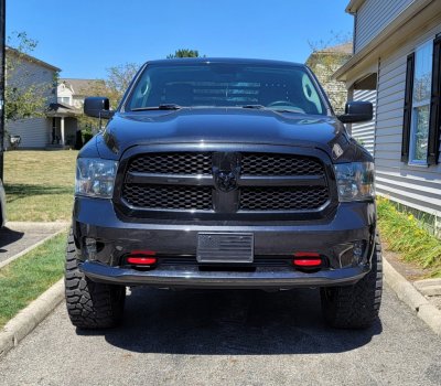

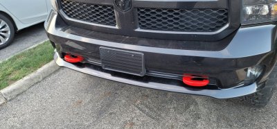

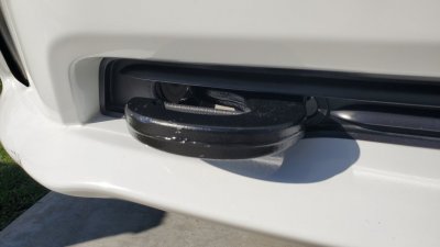

Got my hooks in! The brackets are awesome and make the hooks sit much better than the stock ones. Also thanks to @JB1 for his trim idea, cleans it up very well

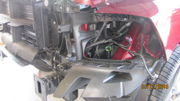

FLYxxBOY, very clean looking install. Did you remove the plastic piece for cutting, or cut it in place ?
FLYxxBOY
Feb 12, 2020
58
75
Ohio

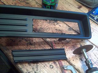

Thank ya, took a while but I think it turned out good. So the method I used was to take the plastic piece out, installed the hooks, used some painters tape and taped around the hooks so I knew where to cut, removed the hooks, put the plastic piece back in, then using the tape as my outline used a 1 1/4 hole saw to drill the ends, and a hobby knife to cut between them. Then added the trim stuff to make it look neat and installed the hooks again.
Badger 13
Jul 30, 2018
1,368
1,542
North Idaho
2013 Dodge Ram 1500
Thanks FLYxxBOY, it did come out very clean, and gives the look of a "factory option". I was looking at removing the plastic piece, but it looks like a PIA to remove, and reinstall. If I want to achieve the good look of yours, I guess I better figure out out to take that piece out.
Thanks again.

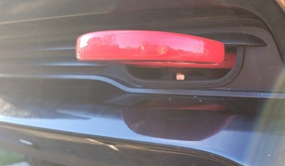

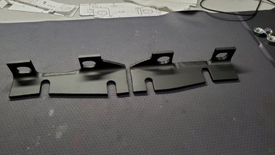

Thanks to @Ken226 I was able to grab his pdf files, scale them on the printer, and use them as a template to create my own brackets which worked out perfectly. It took $50 worth of carbide blades and at least 4 hours of my time to work the 3/16" angle iron with saws and a drill press, but in the end turned out exactly as I had hoped. Used OEM hooks from ebay which I sand blasted and repainted. Thanks to everyone on this thread for paving the path !

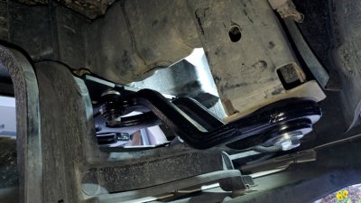

What exactly do the brackets do for you? I didn't read the thread
Uncle Damo
Dec 31, 2014
40
32
the brackets allow you to position the hooks wider and aligned with the larger opening in the fascia, as well as face them outwards. You could use the OEM brackets without those two benefits.
