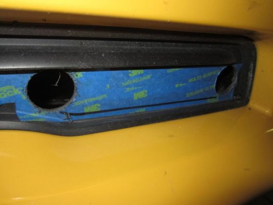

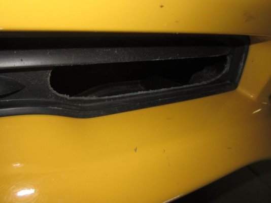

:) That's just a standard 1-1/4" wood hole saw(hand drill)-
JIMBO, what size hole did you drill for this? Looks like you did it on the truck instead of removing, is that correct?
It' s only 1/8" soft plastic and there's no reason for the removal of the FACIA anyway-works in a couple minutes using a Keyhole saw
Took me about 10 minutes for both layouts/cuts--Kens brackets allow almost 1/2" lateral play for the TOWHOOK positioning--
--"DYNOMITE"--
Good luck-
:crazy: JIMBO
