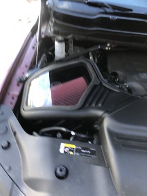

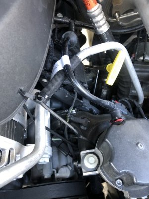

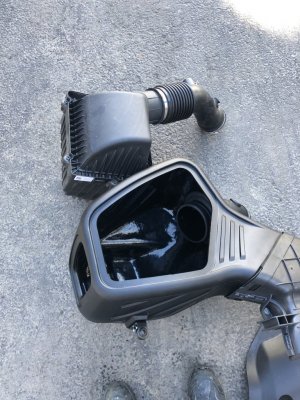

The install went smoothly S&B provides good directions. Only issue was one of the ball snaps that hold the engine cover on broke so I used zip tie around a solid point to hold the right side of the cover secure. Unfortunately (but not surprisingly) my cameras now don’t work. First and last step of install is unhook the negative battery terminal so maybe having the battery unhooked caused some glitch. I assumed something would go wrong after the install but I figured it would be some warning might not that my cameras don’t work. Any thoughts? I might just bring it to the dealer let them figure it out
In other news my axles unlock flashing light seems to be fixed. Picked it up from the dealer yesterday they replaced some parts that didn’t solve it and finally did something with a rear axle sensor. Haven’t tried the lockers yet though
Here are some photos

I was thinking of going with this set up, but kept the OE box and installed a green filter instead. The OE box is allegedly pretty good air flow. What about it was a gamer changer over the OE box?
A
Astewartconst
Jan 1, 2021
88
56
Illinois
Probably nothing is a game changer over the stock setup. I assume possible marginal power gains maybe but overall so far all I can say is the truck sounds a little better can hear the intake and engine growl a bit more than before
