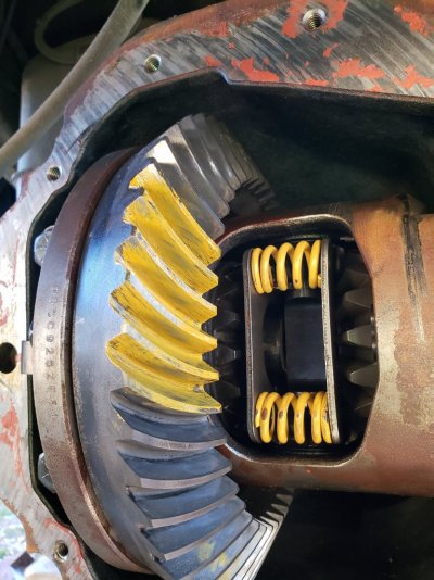

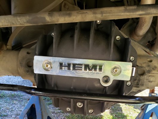

UPDATE: Installed JEGS Posi (LSD) into my ZF 9.25 to replace the open carrier. Replaced the parking brake shoes at the same time. All went smooth and am very happy with the results. A special thanks to DILLIGAF for help with the proper specs for the ZF diff. I also replaced the OEM diff. cover with an aluminum B&M cover. Perfect fit. Fits both New Process and ZF 9 1/4" diff housings. Clears the sway bar and panhard arm. 20221024_103832.jpg20221024_144501.jpg
