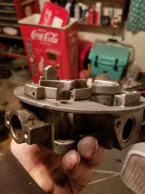

This is where i have a question ... What is this small hole on the top of the throttle body? it had a small screw in it.20171207_213235.jpg
And also how bad does this plenum gasket look?

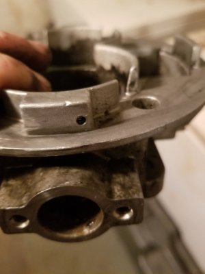

jlbayes.. thanks for the advice but do you have any idea what that smaal hole in the air horn is?

Sorry I do not.

jlbayes thanks anyways lol i dont think its too important most everybody i have seen on here that has done this has cut thosair horns off and im going to do the same just wanted to make sure before i did

If you're talking the threaded hole it's just the factory mounts for the dakotas and other vehicles, they don't use the clamp like ours

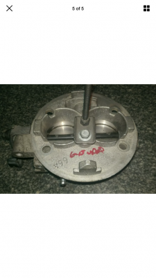

Alright guys can anyone tell me what thread stud goes in the middle of the throttle body between the butterflies??????
DodgeDude99
Aug 16, 2016
594
283
Oak Lawn, Illinois
1/4-20, if your trying to use a standard air cleaner, you need to put a 1/2” offset bend in the threaded rod.

Thanks dodgedude99 And its for the k&n intake i have on it .. it bolts straight down with no offset
