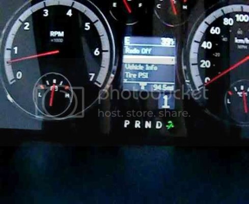

He's using the second prime up-shift the first 4G Rams with 545RFE's used for drag racing.
Only on the 65RFE its called "3rd" gear now,
not in the normal upshift sequence , you engage it manually.
BlackRamHemi
Aug 14, 2013
1,266
558
Edmonton Alberta Canada
2010
545RFE:
1st 3.00:1
2nd 1.67:1
2nd Prime 1.50:1
3rd 1.00:1
4th 0.75:1
5th 0.67:1
2nd prime (now called 3rd in the new 6 speed)
is utilized only as a kick down (aka passing gear) in normal D mode
You can manually force it into the upshift sequence by holding the floor shifter left.
For me delayed my trans going into 3rd gear at the track by a second or so,
for higher MPH, and a quicker ET.
Here's what it looked like on my EVIC,
there is no 2nd prime designation, so it falsely reads 3, then when it shifts to 4 on the dash I'm actually in 3rd gear going through the traps (click pic for vid)
vid is about 4 years old, shortly after I bought the truck
