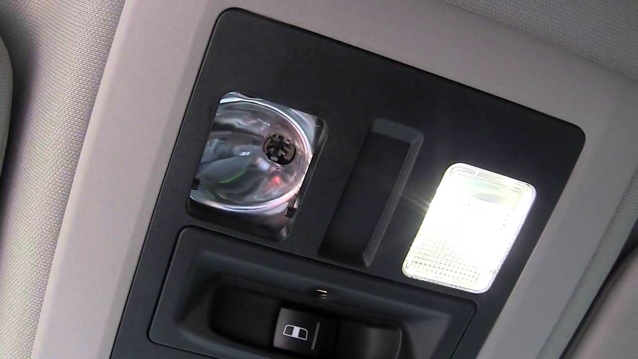

There are YouTube videos about it
watch the videos on replacing the bulbs with LEDs
& the little trick on how to get the old bulbs out
I think the video about pulling the overhead console, can be found under installing Homelink buttons into overhead console
Light bulbs can be tricky, that is why i chose different videos
2013 Ram 1500 especially
?? https://www.youtube.com/watch?v=7Xk1fYvi5iM ??
