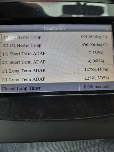

Diagnostic box today. What is the consensus on the long term? Driving along, suddenly the numbers will go to zero and then back to what is displayed. Any ideas or suggestions? Wondering if it is a pcm failure....
Any ideas or suggestions for the long term adaptive readings.
