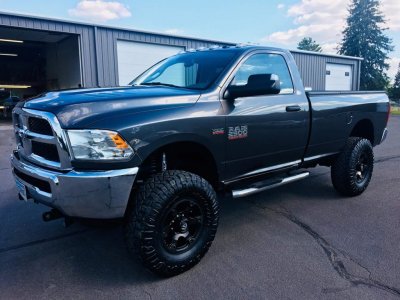

I have the 4" BDS on my '16 single cab.
After doing the math, the kit was about $1100., and $750. for the install. Has the Fox 2 shocks. Your still going to have a firm ride, but better on the 37's aired down to 50psi. Factory Firestones at recommended pressures ride hard. Steering is great and tight, no aftermarket stabilizer.
I'd do it again, anyday.

Well wheres the pics?! I like me some single cab!

The installer bought it from BDS. The kit is still listed on their site. The truck now sits level, so really is a 4" front, about 2-1/2" rear lift.

Looks good! Must be 37’s?
Any issues with the plow angle with the lift, or did the bracket lower down enough to get it back to normal height?

Plow bracket lowered enough in the lowest position to compenate for the lift. I do run the factory 33's to plow, as the 37's won't allow me to connect the plow.
Zero issues plowing since the lift in 2017.
