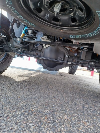

crazy jerry
Apr 5, 2016
1,306
921
WY
this is newer pw housing. photo taken april 23. if this was the first year im not sure. appears the same as all other 19+ 2500 trucks. if any 11.5 guts would fit in there i dont have that answer either
