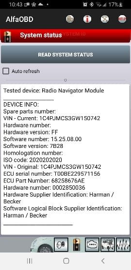

OK so I went to look and all pins are fine. Played around with alfaobd and was able to dump the fw info from the unit. I attached it below.
One interesting this is that there is some radio buzzer function test on alfaobd. When I activated anyone at random, I got the sound to play. Audio started working but controls did not work. I had to use my phones bluetooth volume to turn it down. After powering down there was no volume again until I played with the radio buzzer on alfa.. anyone know what that is ?a7cf383a4fa1133b0fb5e507080b307a.jpg
Sent from my SM-G965W using Tapatalk
Not sure, but I do see something interesting there. It looks like the radio is still on firmware ver 15.x, despite the UConnect site telling you it was up to date. Mike's suggestion to get the dealer to download the newer firmware to a USB for you might be the way to go.
