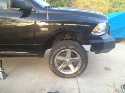

Here is what it looks like. I measured it before it was 37. After 40 1/2image.jpg
ATOM
Sep 13, 2012
461
21
wow that is high for just bilsteins on stockers :think: i was that tall on 35's if i remember right. for you sake i sure hope that don't come apart

Do you think I might need new upper control arms since they just spin?
ATOM
Sep 13, 2012
461
21
the ball joint will spin, thats why you need to hold the stud with the 10mm wrench as you tighten the 21mm nut
Jameson
Sep 11, 2010
547
173
Fort Benning, GA
Oh lawd..driving with upper BJ threaded once or twice is not great idea man. Jack the LCA up to close the difference between the uca and spindle, then take the top portion of your floor jack handle and pry the upper BJ tight so you can tighten the nut. You don't have a spacer in there still do you? 40.5" is a lot on stockers...
