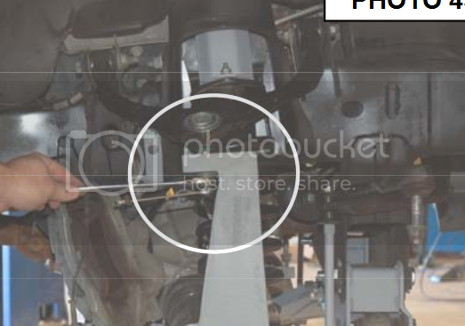

you need to put a 10 mm wrench on the stud of the ball joint and then tighten the nut up the rest of the way

do you have a pry bar to force the arm further down? or try jacking up the lower control arm? but if you do the latter be careful, that **** can get real damn quick. so can you get a 10mm on the bottom and a wrench it the rest of the way tight?
