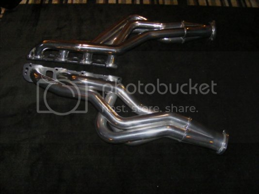

Do you think all your fitment issues were all due to the Ram Runner setup?
Is yours a 2WD or 4WD? (mines a 4x4)
I have my JBA LT's still in the box and have been thinking about selling them.
Mine are silver ceramic coated so if they need to be modified with a BFH to fit,
the coating will be destroyed.

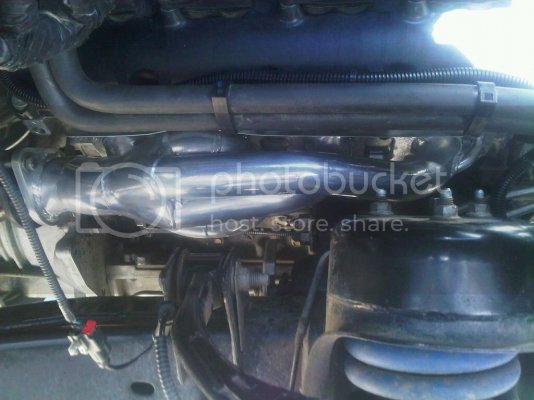

Yeah the passenger side issue was all because of the larger shock tower. I had to heat up and hammer the primary in on the first cylinder and take a barrel sander and trim down the tower to get it to fit. I took it through some whoops and quick elevation changes to encourage a little self clearancing. On the driver side though, you will have to remove the shift cable, and re route it and beat in the first cylinder primary to clear the u joint on the steering shaft or else it will hit when you turn left under power and lock your steering up. That wasn't a fun discovery. Everything else tho was easy. Pretty good fit but hell, there's so much room in there now that I can stand on either side of my motor from inside the engine bay.

I installed JBA shorty headers on my 10' 4x4 two years ago without issue,
...so assumed the LT's would fit without issue too.
I paid extra for Silver Ceramic Coating, So I will send these back if they don't fit!
I refuse to smash the tube to get it to clear the steering with a BFH destroying the coating.
(and I have the larger 1-7/8" primaries)
I'm going to take some careful measurements before I start removing/installing anything,
just looking at the pictures alone tells me I'm going to have an issue just like you mentioned...
Anyone else have clearance issues installing these on a 4x4?
