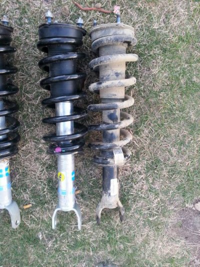

Took about 4 hours to put them on this morning taking my sweet ass time too. First driver side took longer because it was pain to put sway bar link back in after all other components were in. But got em all done and I couldn't be happier. The ball joints look great and so is the ride. The guy I got them from bought the set fir his 2011 ram runner but never bothered installing em. But he had the struts all assembled @ 2.8in with 2011 genuine factory springs and strut top. So it was just a simple swap job for me...[emoji8]
Here is a comparison pic :
There is about an half inch difference in overall length between them... which is well within the range of stock setting

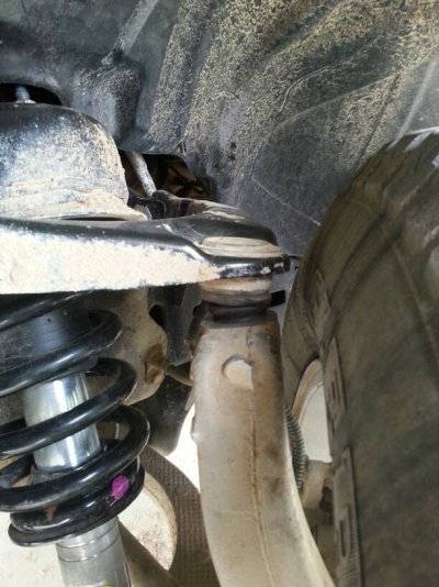

UCA and ball joints :
With the stock strut
With Bilstein at max setting
Honestly I cannot tell any difference just by looking at it. I even think it's sitting better with bilsteins

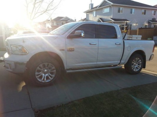

Got an alignment and test drove for a while. Absolutely no vibration nor 4x4 shudders at any speed.
What y'all think?

I got Tufftruck 1223 HD coil springs in the back which raise the back about 1.5 to 2.5 in depending on the weight of loads. My back measures 40.5in and the front at 39.5.
Are you 4x4 or 2WD.
My rear with same springs is 43 1/2 and my front is 39 1/2 inches with 2.8

4x4. Love those springs. Way way better than crappy air bags. Don't u agree?
I got a slip tank and a toolbox that weigh about 300lbs plus some gas and stuff. So my constant load in the back is about 500 to 600lbs I'd say. So without those my back would be the same height as yours
