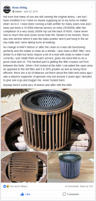

My friend's experience with K&N in an Australian Nissan Patrol is like this:
Wow! The fact I'll never see dirt anywhere near this level in my area solidifies my confidence even more. Meanwhile, I'll enjoy the extra MPG's along with it! :)

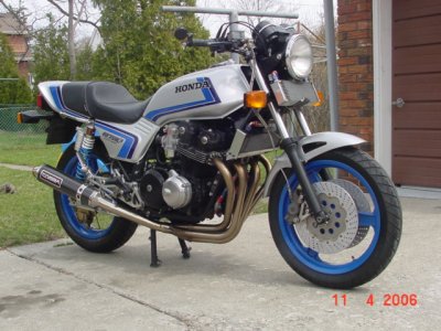

Slightly off topic (slightly?): I use to use K&N products (single pod filters) on motorcycles..mainly in-line four cylinder Hondas that were running CV (constant velocity) carbs (yeah..i'm old school with carbs). Getting the oiling correct was critical or the carburation between the four separated carbs would be upset for the first maybe 100 miles of riding or so, until the oil layer became more evenly dispersed on the filters. I use to hate the lack luster performance during this period. In the end the filters went in the parts bin and I installed velocity stacks and screens. The screens help keep out big stuff like bugs and rock etc.
I took the bike (1982 CB-750F Super Sport) in for a motor refresh the winter of 1990. Rode it to the shop, they pulled the motor, I rolled the chassis home until the spring when the reverse would happen. The bike mechanic saw the velocity stacks and said "Oh boy, theres gonna be big trouble in little China tonight."
I asked him "What do you mean?"
He said, "How long you been running them stacks?"
I said "About 6 years or more."
He said, "I expect the cylinder walls are gonna be a bit of a mess from scoring running without a filtering medium of some sort for that length of time."
I got a call a few days later, "You might like to come in a look at this motor," he says.
So I do. He shows me the cylinder block and said, "I'm totally amazed,..there's not a mark on the cylinder walls to speak of. A simple hone and re-ring and it will be good to go."
I do not advocate running without a filter. I do understand the idea that a K&N is clean-able ergo re-useable, which make them cost effective. But they do not always work the best in certain applications, granted more so related to motorcycle use at least in my experience. I've just given up on them is all.
My 1998 CBR-1100 Super Blackbird goes through a rather drastic carburation upset when a K&N is used, and it does not fit the airbox as nicely as the OEM Honda airfilter...so once again K7N are out.
T.
