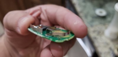

I had an issue on my fob, it would not lock the doors but would do everything else. as it is a 2014 I've been in the fob before to change the batteries when I opened it up this time the switch plate was dirty and I used some contact cleaner with a cotton swab to clean the inside and the switch pads, it works again. youtube videos can show you how to get in the fob without damaging it.. Good Luck!
