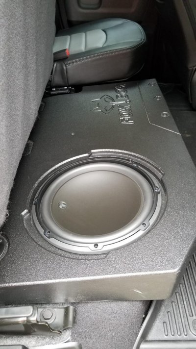

I have a single 12" box - rear passenger side, which yes is the one I got from CL. I just used the pic of the dual b/c is showed the cupholder the best.

It’ll bump! What music are you in to?
All kinds really, but mostly 90's rock/grunge (FF, Tool, POD, AIC, Audioslave, etc, older classic rock ie Rush, Zep, Who, etc and older hip hop as well. Sometimes a bit of older, REAL country music as well...

yeah that fox box hits stupid hard. 500 watts is enough for sure! I figure just use the cup holders that are in the arm rest. not worth adding the fox one imo.

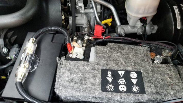

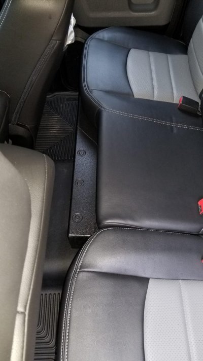

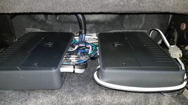

Here's a few pics, It's been raining off and off all day but I snuck out and installed a VaraRam and took some pics real quick...

Install cost was $250, and it took them about 5 hours total. I don't know that they worked on it for a solid 5 hours, but it was there that long. I went and played golf :).
I'll likely be adding JL Audio C2's in the doors very soon. The Pioneers just can't handle the power of the 400/4.

what part of the firewall did they run the power wire thru?
