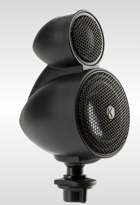

When our new "snowman" comes out, I want to try a set on my Jeep GC.
:popcorn:

In my RAM, not sure yet. I dont want to go really custom, so Ill probably get speakers that fit in stock spots and a Key amp. Or maybe a component set and 3d print a small "pod" for the tweeter to mount on the door panel (without drilling, hopefully)
