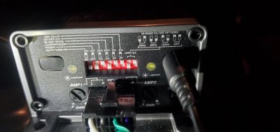

Ideally, the amp's gains should be set before the auto tune. The auto tune is supposed to set the levels between speakers. Now, by set, I mean a rough adjustment, it doesn't have to be perfect, but if they are too low, I don't think it can raise them.
Defeat all of the tuning except the crossover, and set the gains by ear so that the high end sounds balanced with the door speakers, and the music is as loud as you'd expect considering the volume level on the headunit (max undistorted output before the max volume on the headunit), then rerun the tune, but don't change the gains afterward, unless it's a very small change.
