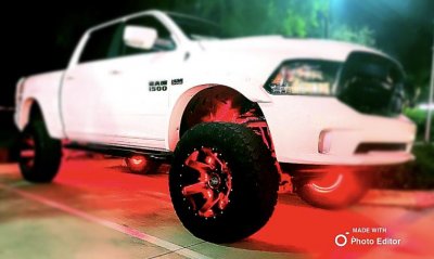

Not unless you’re going to really abuse the truck offroad IMO. And if you plan on doing that then plan on having a backup set when it’s rebuild time and you have to remove them and ship them out.
I’ve been in trucks with high quality shocks and they’re worth their price and then some.....but only if you plan on using them right. if not then you’re tying up more $$$ in the shocks than you really need to.
And judging by your setup (especially the wheel and tire setup) your truck’s more of a street truck anyways. I’d pick something more middle of the line if I were you and spend the extra on something else.

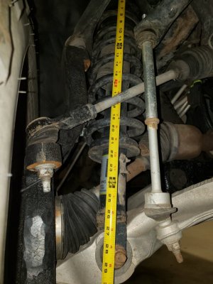

@ram1500rsm I took measurements of the lift spacer, fully extended strut length and hub to fender when resting on the ground. However right now I'm running the pro comp runner shocks in the rear because they're brand spanking new. But I'll put them through their paces and then swap to kings. Overall it's a very easy process to get custom length.
And I believe the additional cost for my custom length was about 200. So 100 per side. Definitely worth a few extra bucks to have a full length setup and filthy offers custom shock tuning with all custom length orders if I'm not mistaken.
Do you happen to have the final measurement ? that should help everybody out ordering 6" Coilovers.
BombSq030
Sep 11, 2018
82
80
FE Warren AFB, WY
28.5" full extended from strut tower to mounting point. However this includes a 5" spacer from the pro comp lift and a 2" leveling spacer. (I know... Don't run a spacer under a lift spacer. Waiting for my King's to show up.) I don't have the compressed length. But resting length is 26 3/8".
