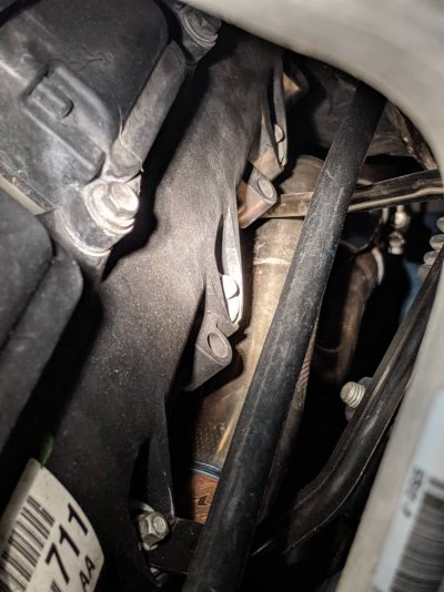

hey guys I'm currently having my headers installed, and my guy is telling me that the oil dipstick looks nearly impossible to route up through the primaries as there's absolutely no room. kooks claims that it will fit and they supposedly include a spacer / bracket that helps it to fit. we don't have that spacer bracket, but if we did it still seems nearly impossible to route the oil dipstick up through the primaries as there's just no room. I'm wondering if anyone has had these installed and you were still able to keep your stock oil dipstick and its location? any pics would be greatly appreciated.ba35ae63bae1dd19bea1afdfd2d8a025.jpg

I don’t have any pics but it can be done. On my old 2013 5.7 I had kooks and there is no bracket. You have to cut the bracket off your dip stick tube and bend it to fit. It’s not that bad, I did it laying on my back. Guy at your shop should be able to do this no problem.

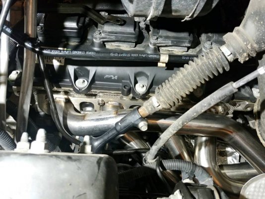

Do you happen to know if your stock dipstick is touching your primary? Or do you know how much clearance is between your dipstick and your tubes? We got my stock one to work, but there's like zero clearance between it and my primary, and when you get on it sometime the knock sensors detect that vibration and pulls timing.

Perhaps they are different. You can see here I have no room.

I was wondering--they make those heat shield casings that go around wires etc and I was wondering if you could put the dip stick holder in one of those. It would help prevent the tube from getting hot from touching the header pipe and also not allow any metal to metal contact. Let me see if I can find a picture somewhere and if I can I'll add it to this post.

I was think about the heavier ones. I used something similar for my shift cable that was realllly close to the header pipes.
