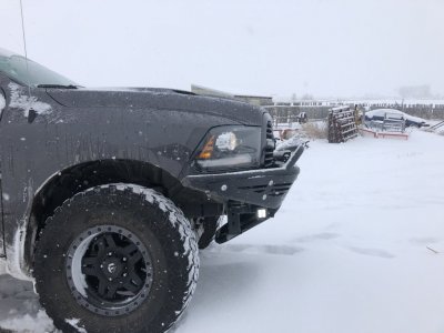

View attachment 159737 Here ya go, and weight of the bumper is maybe a little over 100lbs fully dressed with skid plate and panels
Got any more pics? I never saw this bumper in my searches. It's between this and the body armor for me as of now. Both seem to be give and get in one way or another.

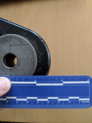

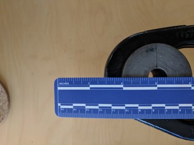

I had a pretty long email discussion with ICI and the great Cust. Service guy took the time to check multiple times to get several measurements for me. The lower flange on the lower mount is angled...and the distance from the bolt slot/hole at it's center to the flange is pretty much exactly the distance between the bolt hole of the tow hook to the rear of the hook (1 9/16").
From ICI custy service:
"The 1-5/16” is from the left of the slot where that blue dot is straight back (up in the picture) to the flange.
The distance from the center of the slot straight back is 1-9/16”
The distance from the far right of the slot straight back to the flange is 1-13/16”
The slot length is 1.25”.
(Looking up from bottom. Rear at top of picture, front at bottom. This would be the passenger side.)
If the bumper were to line up perfectly centered on your truck it would clear the tow hook. Any side to side adjustment would cause one side or the other to be too short for the tow hook and need to be notched"
From @BmSzondi89, showing the driver's side:
My Tow Hook measurements...
1 9/16" from center of bolt hole to rear of hook
1 7/16" from the end of where the slot would be on the bumper, to the end of the hook, if bumper centered
So, if bumper is perfectly centered, I'd have to grind off at least 2/16" of hook...or notch the flange like ICI mentioned. If it's not centered, then it will be more.
Worth it? I'd say yes...if that prerunner bar was higher to allow bigger round lights! As is, it's only 3 5/8" between bottom of prerunner bar and top of bumper and seems made for lightbars...not cool old school off roader lights!
So...I'm in decision limbo once again.

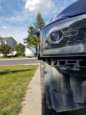

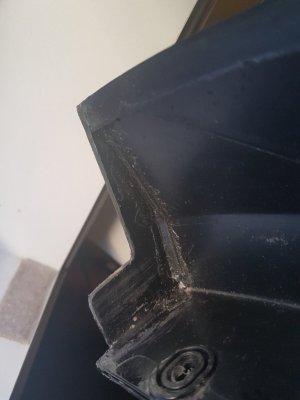

If you choose to cut your flares i got a bunch of info i can give you on that operation too.

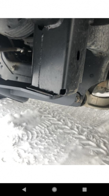

How does that westin mount? Universal mounts that have adapters for the trucks frame? I have an idea to get some shackle mounts on that thing pretty easily since the skids are removable

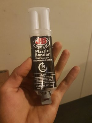

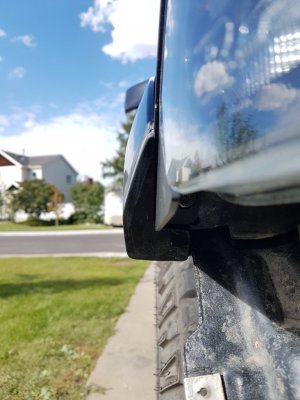

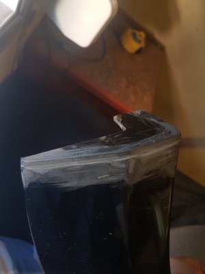

What is this plastic weld ****???
I cut right on the moulded in line on the flare, then i traced a template on some card stock to cap the end. The extra pieces of the flares that i cut off, i used the templates to trace onto those and cut out the end caps. Then i roughed up the back edge and the cut edge on the flare with some 80grit or something and used this JB weld. Sanded smooth, and since im bedlinering them it doesnt have to be absoultely autobody quality perfect, just close.
No ****, I never paid attention to that crap and I've seen it a bunch. I'll give it a try. These flares cost 40$ on eBay so no love lost if i mess em up. Still 50 / 50 on which bumper, I don't have to do **** to the body armor, I just lose a bit of clearance.
https://www.google.com/url?sa=t&sou...FjAAegQIAhAB&usg=AOvVaw0dpyA1W0s9zg0VwfQjjSks
https://www.westinautomotive.com/outlaw-front-bumper/2014/ram/1500
Click the instructions for the bumper and the skid plate to see all the mounts and stuff.
