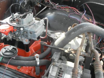

Here's how a Magnum looks when done with a Performer RPM & factory Magnum serpentine drive using A/C lines & compressor from a 92-93 truck
Wow... it looks so small in there haha. That definitely looks easier to do than trying to get the electrical set up properly.
