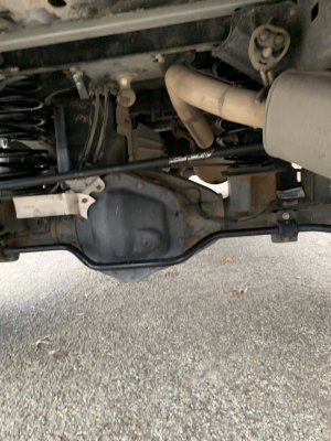

I have my fury 35x12.5-18 mounted on the stock spare 18” rim. It was a no go and I didnt wanna air it down. So I ripped all of the parts off and am having a mount built that inserts into my b&w turnover ball and I’ll just mount it in bed....only need it when I’m going out into desert anyways. Plus I get a workout every time I put it in and take it out. Plus I see more of my Thuren parts hahaha

What’s your e-brake cable bracket doing on the diff?

:boxed: Dunno. That’s where they put it lol. Guess I’ll go through the instructions and see what’s up haha

Who took your money to guess so poorly at where things go?

Yea thats definitely not the correct location. I believe that replaces the wire bracket holder by the drivers side wheelwell.

I’ll get under her today lol. Maybe they’ve never seen such a pretty bracket and thought “now this has to be mounted so the world can see it” :anitoof: It is San Antonio and the labor force is a little lacking in the English reading and speaking department.

The bracket they put on your diff goes on the driver side frame rail, replacing the OEM bent wire bracket.
There is a small bracket that goes on the passenger side lower control arm that you’d need for 2.5” King shocks. If you have Overlands or 2” Kings you don’t need that one.

Yeah I looked it all up today. It’s too cold to get under her. Instruction in English lmao

Bracket is now where it belongs haha. I gotta say. It looked better on the diff and everybody could admire it lol. It had a perfect groove and cutout to fit on that diff. Almost like it was meant to be there.

Yea, while it did physically fit there, weren't they at all wondering why to install it like then when it did absolutely nothing ? ! Lol

Well..... what’s weird is there’s lines directly behind it. Maybe they “thought” it protected the lines or something haha. Everything is is good I went over it all. Still trying to get pressures right in these tires to smooth it out a bit more.
