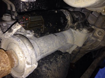

Moved the truck to shovel snow today and noticed a pink puddle underneath the passengers side front. Attaching a couple of pics hoping someone can help? Kinda smells and looks like tranny fluid my washer fluid is pink but it's on the opposite side, help?

That's all covered in oil :(

Anyone?.... Any ideas what it could be or anyone else have any fluid leaks with their new rams?

Could be power steering or transmission. Have you checked your fluid levels?

Fluid levels are still good.. Look like a trip to the dealer for warranty I suppose

Take some pics with fluid on the ground as well, let them know it is serious. GL

I wouldn't rule out washer fluid. Excess from the windshield will drain out .
Try giving the window a good soaking in the driveway and see if you can see it drain.
(looks kinda oily though)
Hope that's all it is. :favorites13:
Sent from my Galaxy S3 using Tapatalk 2
These trucks don't have hydraulic power steering. Could be coolant

my tranny fluid levels are still good but the tranny fluid smells kinda burnt and has a hint of brown on some parts of the cloth? could be my mind playing tricks, but the leak underneath is oily and pink so im guessing tran fluid. ANYWAYS i go to remote start it today, makes funny noises again then shuts off now my check engine light is on.... ******* it. have it booked in for thursday...light still on and remote start is disabled...

dealer did a flash for my check engine light and states there is no issues, as for a leak they said there isnt one..i sent them the pictures i took and they then said it look slike the coolant leaked when it was really cold. but the levels are fine and there isnt a leak anymore... Soooo only time will tell i suppose
