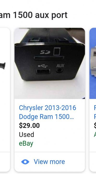

Sounds like there's a short to ground and the radio thinks you plugged or unplugged something.
I being a curious mind and a cheapskate I would try to fix the USB port, it would be easier to replace it.eeb75c6d27f0154325b794a6f4b294c4.jpg

It's that media hub my 14 did that. To get it to stop till I fixed it I took an old pair of headphones and cut the plug off and left it plugged in. So it always showed a source and stopped trying to switch back to it

So I plugged in an aux cord yesterday and it hasn’t happened since. Thanks
