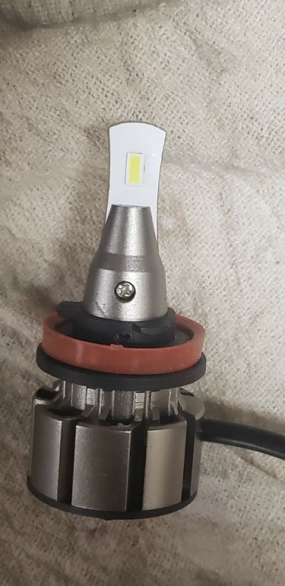

What’s involved in clocking the fogs? Trimming the lock tabs?
Not much. Under the seal o-ring there is two screws 180 degrees apart. You remove those screws which allows the mount collar to be removed. Drill two new holes at 90 degrees from the original holes. Put the collar back on using the new holes and install the bulbs.
This is a picture of the H11 bulb but the 9005 is similar. The screw you are removing is the black Phillips head just above the seal.

Easy enough. Thanks.
