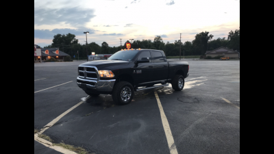

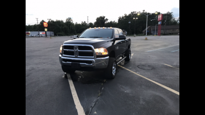

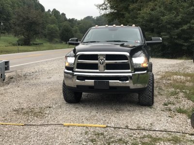

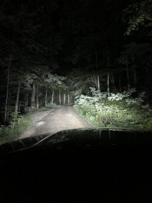

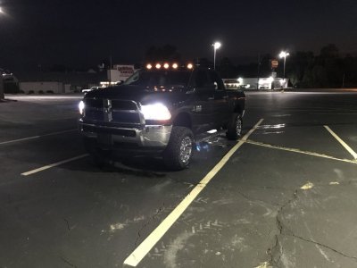

So as everybody knows the factory quad headlights are pathetic. I did a lot of research trying to find a headlight upgrade that didn’t require putting in projectors. Headlightexperts.com had exactly what I needed. It was around $100 for low beam and $100 for high beam. They claimed that the beam pattern was made for the reflector type headlights so they wouldn’t blind on coming traffic. They were correct, the pattern looks just like factory except a whole lot brighter. The bulbs are 4,000 lumens. I’ve had them for a few months now and I couldn’t be happier with them for a $200 upgrade. I’ve had the cheaper eBay kits and it seemed like they only worked half of the time and weren’t nearly as bright as they claimed. Same with the HID’s, they were always having some kind of problem!

I'm assuming the output shot is with your high beams on? If not, dude you are going to kill someone.

I didn’t think to get any good comparison pics of before and after so I apologize for the lack of good pictures showing the difference

Now that i look at it I think the before pictures are the factory low beams and the after pictures are the led high beams so the output looks a little more exaggerated than it actually is
