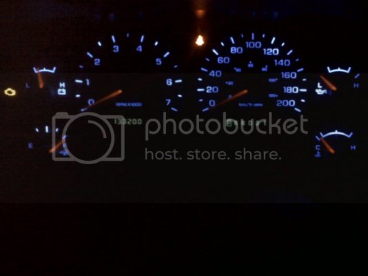

just installed the blue ones tonight could not get the led bulbs to fit in the climet controls ant tips?
Marx
Jul 4, 2010
271
24
Southeastern Ontario Canada
Hemi 5.7L, 345 ci MDS
wow marx that looks really good! So the blue LED's still light up the red needles? SWEET ACTIION!
i think the needles have there own light (soldered to the board), the blue does not light up the red on the fuel (E), oil (H) temp (H) and battery (L) but it doesn't bother me
what about the odometer and gear selector?
gonna get film for that
also i could not get the leds in the climate control i think it has a different base mine would not turm
